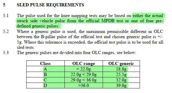

In the mentioned EuroNCAP protocol I found:
2020-02-11 12_46_43-Window.png (72.79 KiB) Viewed 36024 times
So there might be also a generic pulse used for the test.
Also the pulses are referenced by A,B,C,D:
  • S0PULS????0AACX?
  • S0PULS????0BACX?
  • S0PULS????0CACX?
  • S0PULS????0DACX?
Is an option, but will require new FL3 codes and is may difficult to read.
