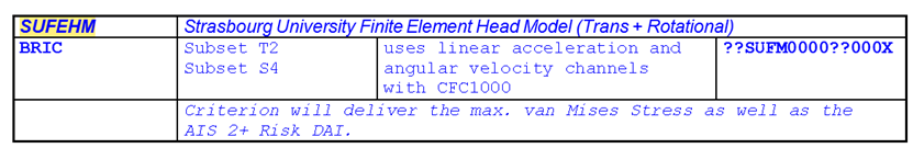

a while ago I have started to prepare a coding for RED E.
It is "work in progress" (ignore the word BRIC in the snapshot below), but may useful for the discussion:
I would like to move this discussion to the RED E board.
@Paul: Is this possible?

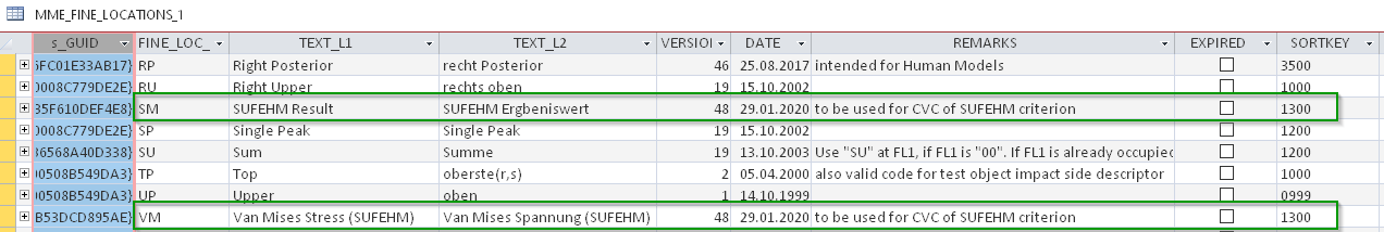

I have added to the database 1.6.2:
In Fine Location 1 table:
2020-02-05 20_03_59-Access - mme_code _ Datenbank- D__Daten_03_Projekte_10_ISO_02_DB_##Work_02_Versi.png
2020-02-05 20_03_59-Access - mme_code _ Datenbank- D__Daten_03_Projekte_10_ISO_02_DB_##Work_02_Versi.png (31.77 KiB) Viewed 52202 times

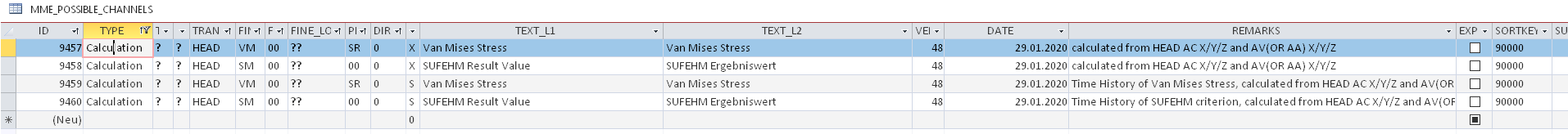

In the Possible Channels table:
2020-02-05 20_11_09-Access - mme_code _ Datenbank- D__Daten_03_Projekte_10_ISO_02_DB_##Work_02_Versi.png
2020-02-05 20_11_09-Access - mme_code _ Datenbank- D__Daten_03_Projekte_10_ISO_02_DB_##Work_02_Versi.png (30.46 KiB) Viewed 52202 times
Sorry for the small images, but they are shrinked by the system.
So please find the two images also in the attached archive.
SUFEHM Codes.zip
(53.88 KiB) Downloaded 1592 times

The "stress" (VM) is named after Richard von Mises. Therefore, could you please correct in the TEXT_L1 and TEXT_L2 "Van" to "von"?
Sebastian
Re: Channelcodes for SUFEHM channels
Dear Sebastian,
thanks for the hint.
I have changed this in the FL1 and the Possible Channels table.
