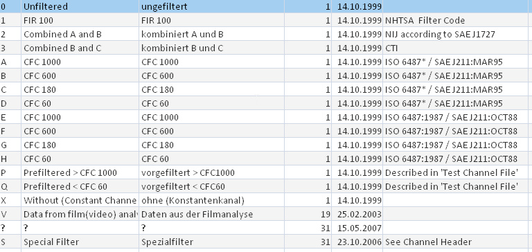

To have an overview for the discussion of the possible characters for new/additional filter classes, I have made this picture:
The current classes in the database are:
New Filter Class Character for CFC20

The decision in the todays Task Force Meeting was:
The new code "L" is available in the next version of the database after the offical 1.6.2 (1.6.3?).
Clarification for the need of the new class:
The base idea was to have this class for Dummy Qualification purpose.
We suggest that it should be used in the future for quasi static applications (Hip/Torso Flexion) for angular rate processing.
Alternatively, the intention could be, to have it for angular rate processing in (neck) pendulum test like for the THOR?
- to reserve the character "L" for CFC20
- to leave the character "K" open for a class CFC30, referenced in EuroNCAP for Puls analysis
