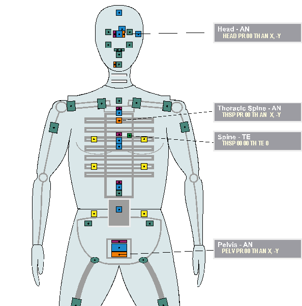

currently we have defined the following tilt sensors for the positioning of the THOR dummy:
??HEADPR00THAN X/Y ?
??THSPPR00THAN X/Y ?
??THSP12PRTHAN X/Y ?
??PELVPR00THAN X/Y ?

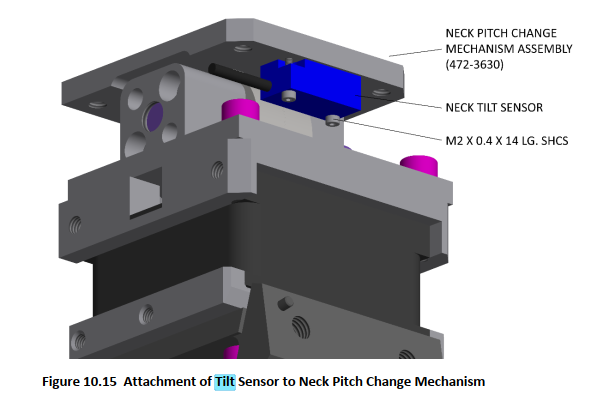

But there is one more tilt sensor needed for the THOR at the Neck Pitch change:
TH Tilt Sensors.png (5.28 KiB) Viewed 29587 times
TH Neck Pitch Change Tilt Sensor.png (49.62 KiB) Viewed 29587 times
So I would propose to add:
??NECKPR00THAN X/Y ?
We also need to add in the current figure of the TH the THSPPR12 sensor.

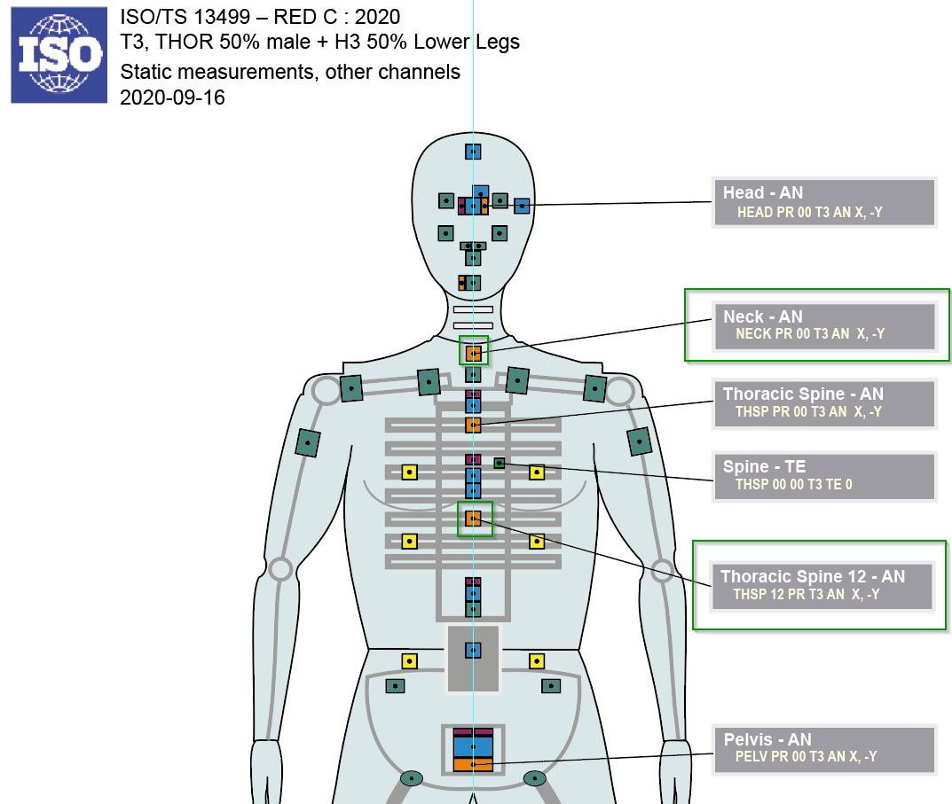

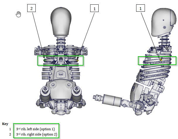

I have implemented the new locations for the tilt sensors in the figures:
According to the manual the locations are:
The new locations of the temperature sensors are not included as we decided to await the complete rework of all figures after the new release 1.6.2.
