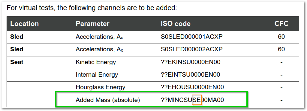

EuroNCAP - Data acquisition and Injury Calculation now CP005 V1.3
According to the decision today we added the FL2 "SE" for the requested coding of Mass increase for the seat in CP005 V1.3:
So, we added:
