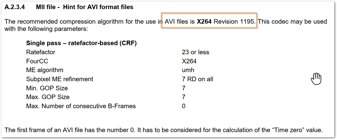

I forward here some feedback to update review the Video Codec recommendations in 2.3.2 / 2.3.4:
2023-08-21 11_18_50-2020_06_17_ISO_TS13499_RED_A_1_6_2 - PDF-XChange Editor.png
2023-08-21 11_18_50-2020_06_17_ISO_TS13499_RED_A_1_6_2 - PDF-XChange Editor.png (14.58 KiB) Viewed 20772 times
2023-08-21 11_19_54-2020_06_17_ISO_TS13499_RED_A_1_6_2 - PDF-XChange Editor.png
2023-08-21 11_19_54-2020_06_17_ISO_TS13499_RED_A_1_6_2 - PDF-XChange Editor.png (82.33 KiB) Viewed 20772 times
