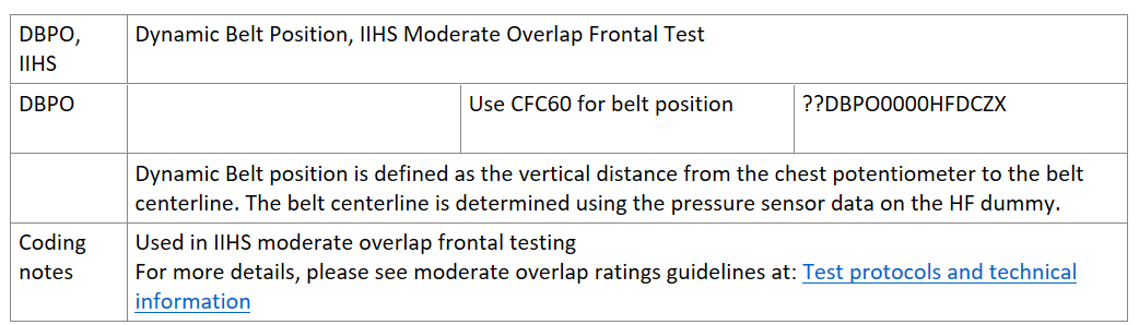

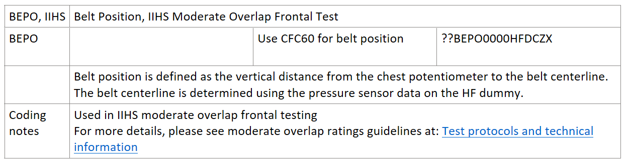

Hi All, I have the following proposals for two metrics from xsensor jacket that are used in IIHS testing. I attempted to align this with the RED‑E document; however, I am not fully familiar with all of the requirements, so I would appreciate any feedback.
Both these metrics are developed and used for HIII 5th dummy only hence I have HF in there instead of ??
Belt position:
This is a distance measurement in Z direction (DCZ). We get this by processing the data from xsensor jacket mounted on dummy's chest. One alternative can be ??CHSTBEPOHFDCZX, but I was not sure if CHST only reserved for sensors inside the dummy?
Chest Index:
This is caluclated from belt position and thorax compression channels.
