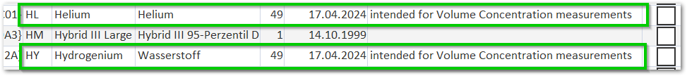

Proposal is accepted and the following extensions have been implemented in the database:
Topic is closed.
