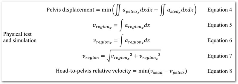

in the IIHS Rear impact protocol dated 2025-12 there will be new criteria introduced.
  • Pelvis Displacement (relative to sled) X
  • Head-to-pelvis relative velocity (resultant from x,z)
IIHS Whiplash Codes_Formulas.png (40.09 KiB) Viewed 8031 times
https://www.iihs.org/media/f3cb3842-ddc ... ec2025.pdf
If these channels are visualized, stored or exchanged there will be a need for an ISO coding.
Also if the result values could then be stored in a CVC (Calculated Value Channel; see RED E).
There is a request and proposal from Björn for discussion in the next meeting (2026.03.):
Pelvis Displacement
PELV0000BRDSX
  • + build from existing code parts
  • - relativ information is missing
Head-to-pelvis velocity:
OCCUUPLOBRVER
  • - concrete measurements are not referenced
  • - x,z resultant is not expressed in the code
An alternative could be to introduce specific MainLocations that will reflect the
two Main Locations involved. Like:
HEPE for Head-to-Pelvis
PESL or PESD for Pelvis-to-Sled
Still, this will not solve the resultant just from x,z for the coding.
