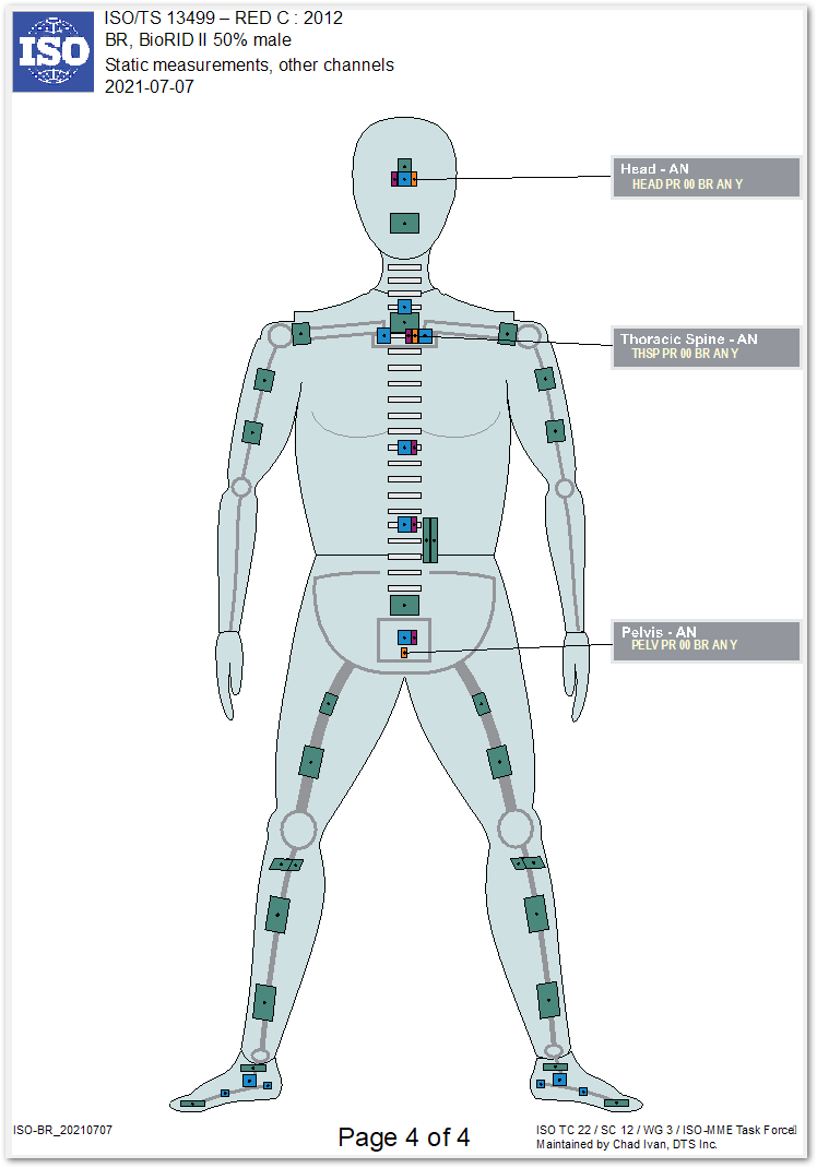

I just realized that in the BioRID figure the temperature sensor code is missing:
Code might be THSP0000BRTE0.

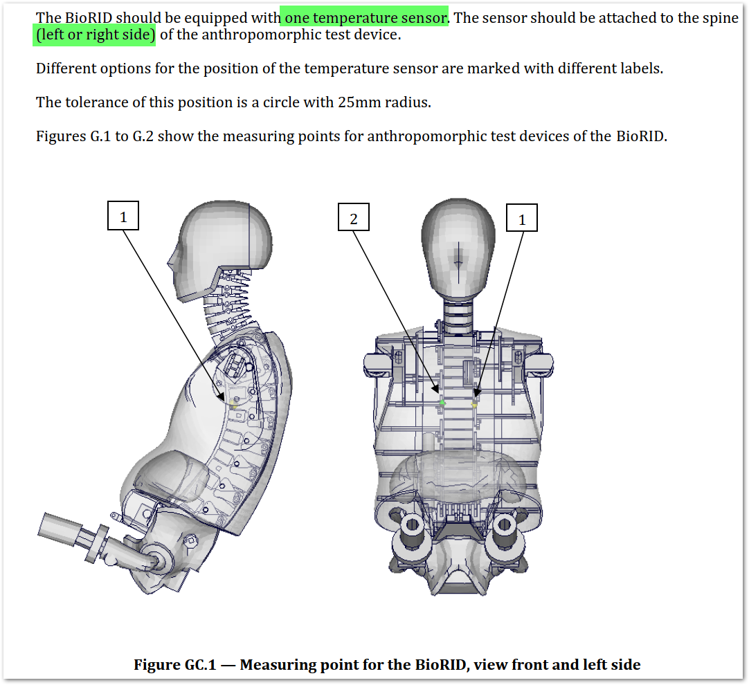

Location should be best taken from:
ISO/DTR 27957 " Road vehicles — Temperature measurement in anthropomorphic test devices — Definition of the temperature sensor locations"
Is there a need to specify LE or RI in the code?
Other dummies will not reflect the side.
Missing temperature on BR figure
