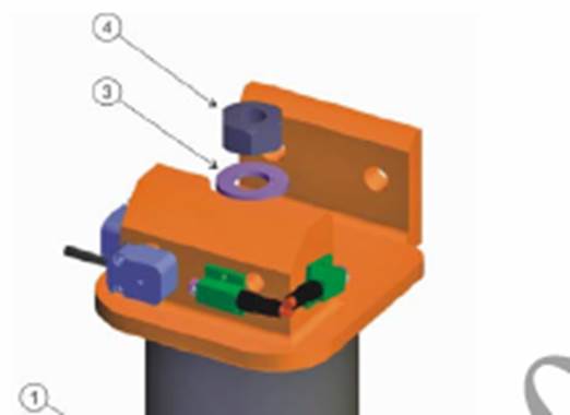

...some more feedback on the QA Coding from Humanetics:
"There are no provisions take to measure the T12 AV in the Z direction.
See the screenshot below." I guess the blue ones are the AV-sensors and you cannot mount one on top of the Spine Adapter.
So we need to remove from Figure 2 the THSP12 AVZ from the box and from the database.
Kind regrads,
