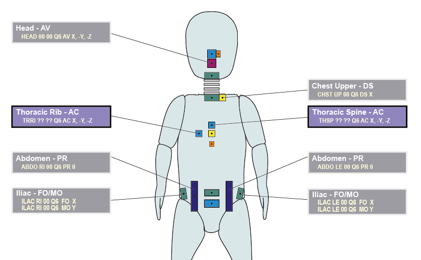

Q6 Iliac Load Cell Codes
in the same manner as for the QA (Q10): http://www.iso-mme.org/forum/viewtopic.php?f=89&t=533
I have added the codes for the ILAC LC for the Q6 to the database:
??ILACLE00Q6FOX?
??ILACLE00Q6MOY?
??ILACRI00Q6FOX?
??ILACRI00Q6MOY?
The codes have been added to the second page of the Q6 figure (Additional instrumentation):
Re: Q6 Iliac Load Cell Codes
here is the figure
ISO_Q6_20170405_Dive.pdf
first pdf version
(208.46 KiB) Downloaded 1206 times
