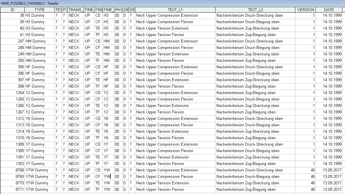

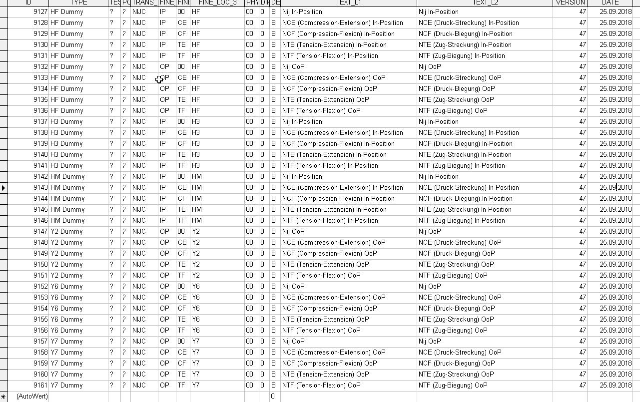

I have implemented the new codes for NIJ signals in the DB: 1.6.2 proposal 3
The following codes have been added:
New NIJ-Codes in [MME_POSSIBLE_CHANNELS].png (89.29 KiB) Viewed 25654 times
All older Codes based on NECKUP have been expired in the DB.
I have not added the new codes for the 6-Year weigthed dummy (YW), as
I expected that his dummy in is not used in OoP testing.
Re: Codes for NIJ Parts
I verified the new coding for the Nij and finally the codes I supplied now
in the database are already conforming to the coding approach for CVC's in RED E.
So only my first proposal (green text) has been mixed the FineLocation1 and FineLoaction2 coding (now edited/corrected in the post).
So the coding style will be like:
11NIJCIPCEH3000B
