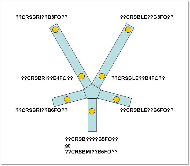

A Child Restraint belt system often uses a separate belt system. The configuration is like a belt harness (H-belt), but with a additional belt between the legs (5 point harness).
Coding should comply the the FL3 coding of the normal belt (B1,B2,B3...). There are two straps acting on the chest. So LE/RI will be used to distinguis between the two straps.
To code the typical measurement locations on the Child Restraint belt the following location codes are sensible:
Possible Channels
??CRSBLE??B3FO?? = Seat Belt Child Restraint at Upper Diagonal Belt(left)
??CRSBLE??B4FO?? = Seat Belt Child Restraint at Lower Diagonal Belt(left)
??CRSBLE??B6FO?? = Seat Belt Child Restraint at Lap Belt Outside (left)
??CRSBMI??B5FO?? = Seat Belt Child Restraint at Lap Belt Inside (middle)
or optional (because on the inside there is just one belt and middle is not really needed)
??CRSB????B5FO?? = Seat Belt Child Restraint at Lap Belt Inside
In the database there is also a CROB Crotch Belt (=Schrittgurt). But here it is not clear if this intended to be used for Child Restraint Belt system.
??CRSBRI??B3FO?? = Seat Belt Child Restraint at Upper Diagonal Belt(right)
??CRSBRI??B4FO?? = Seat Belt Child Restraint at Lower Diagonal Belt(right)
??CRSBRI??B6FO?? = Seat Belt Child Restraint at Lap Belt Outside (right)
The B5 and B6 are normally used for:
B5 = Seat Belt Lap Belt InSide
B6 = Seat Belt Lap Belt OutSide
For the Child Restraint the inside and outside are understood a little different. The middle belt between the legs is on the inside and the two belt staps are on the left and right side on the outside of the Child Restraint.
I had prepared a small sketch for this.

There has been a request to extend the coding for a 5 point harness also to adult belt systems.
To follow the coding idea of the above child restraint belt systems coding this will lead to the coding:
Left
??SEBELE00B3FO?? = Seat Belt Harness at Upper Diagonal Belt (left)
??SEBELE00B4FO?? = Seat Belt Harness at Lower Diagonal Belt (left)
??SEBELE00B6FO?? = Seat Belt Harness at Lap Belt Outside (left)
Right
??SEBERI00B3FO?? = Seat Belt Harness at Upper Diagonal Belt (right)
??SEBERI00B4FO?? = Seat Belt Harness at Lower Diagonal Belt (right)
??SEBERI00B6FO?? = Seat Belt Harness at Lap Belt Outside (right)
Middle
??SEBEMI00B5FO?? = Seat Belt Harness at Lap Belt Inside (middle)
or optional (because on the inside there is just one belt and MI= middle is not really needed)
??SEBE0000B5FO?? = Seat Belt Harness at Lap Belt Inside
In the database there is also a CROB Crotch Belt (=Schrittgurt). If we decide to use the above proposal for CRS belt system it is sensible to keep the same scheeme here.
We then may expire CROB as we have already done with BDIA and BLAP before.
