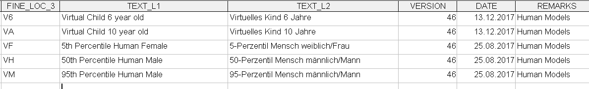

Re: Proposal for Human Model
Posted: Tue Oct 24, 2017 1:39 pm
by emrah.yigit
we (Audi) discussed with VW, Porsche AG and ASTech a new proposal ragarding the fine location 3 codes for virtual human models. We agreed the following codes:
VH : 50th Percentile Virtual Human Model
VM : 95th Percentile Virtual Male
VF : 5th Percentile Virtual Female
V6 : 6 y.o. Virtual Child
VA : 10 y.o. Virtual Child
Can you please discuss this proposal in the next ISO Meeting. This proposal should replace the previous request (Fri Oct 06, 2017 9:41 am, FL3 Codes for Human Models)
Best Regards
Emrah Yigit
Posted: Sun Dec 17, 2017 1:06 pm
the new coding is now included in the 1.6.2 proposal 2:
Please respond on the naming. Actually I am not satisfied to have:
Virtual <-> Human (or in German: Virtuell <-> Mensch) mixed.
It is "only" the longname, but I would like to have a general accepted
wording in the database.
In the figures there will be the one general figure to describe the
special main location codes of Human Models.
