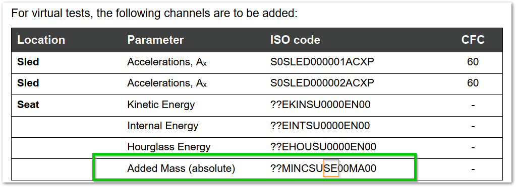

Posted: Thu Mar 19, 2026 9:20 pm
According to the decision today we added the FL2 "SE" for the requested coding of Mass increase for the seat in CP005 V1.3:
So, we added:
