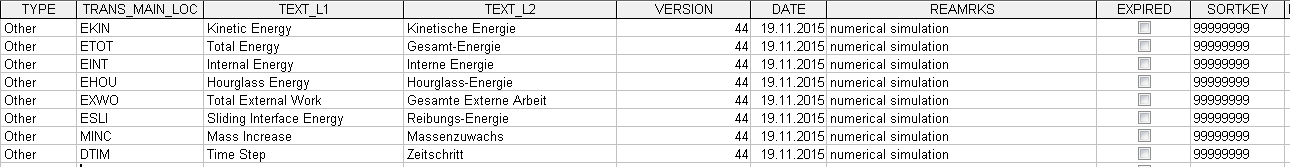

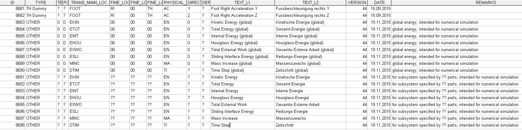

Dear Colleagues,
the codes have been added to the current development database 1.6.2p1.
But I am not so lucky with the German naming.
Any suggestions welcome
New Codes in PossibleChannels
New Codes in Mainlocations
