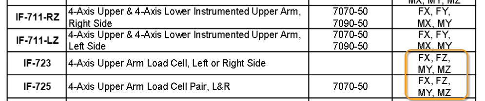

I miss the follow codes:
HIII 50%:
UPAR RI|LE UP|LO H3 FO -Z
UPAR RI|LE UP|LO H3 MO -Z
THOR 50%
THSP 01 00 TH AV X, -Y, -Z
THSP 12 00 TH AV X, -Y, -Z

HIII 50%: ...
you are right, there is variant available for the Upper Arm on the H3, that is not covered by the Figure and the Database for Z direction:
THOR 50%: THSP 01/12 AV X/Y/Z
Is this Standard Instrumentation? The would match best to the first TH figure, but is titeled "Standard instrumentation".

HIII: Exactly this is the loadcell I mean
THOR: is not an standard instrumentation, but it is possible to build and maybe useful for analyze of dummy kinematic.
