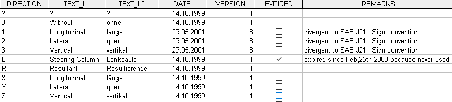

in my opinion the "0" code might apply here still. Even if the wording "Without" is not the best naming for it, the "0" code is used if no specific direction is addressed.
A better longname for “0” might be: "no specific direction".
For example a belt force will be coded with "0" direction or often the voltage and event channels.
My you can describe your application that has a need for this coding?
So we can think about it or provide information which codes are used by other labs.
2019-01-22 22_00_28-Microsoft Access.png (12.71 KiB) Viewed 18137 times

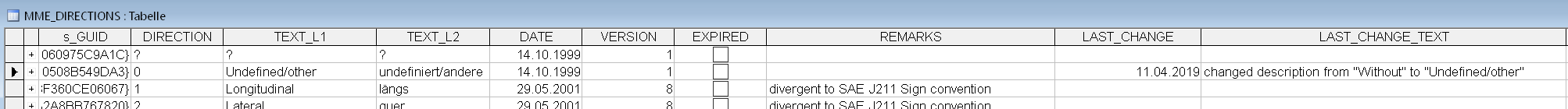

decison of the TaskForce:
Change desription of code 0 from Without to undefined/other
Re: Arbitrary Direction Code
Posted: Thu Apr 11, 2019 2:07 pm
changed in the Database 1.6.2 proposal 3, 2019-04-10 16:06:00
