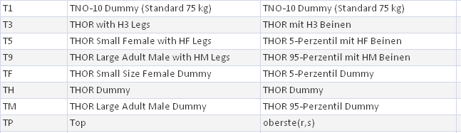

a) Will there be also other AV-Dummy in the future, that are not THOR based?
b) Will there be much more other sizes/classes beside 50th and 5th? (95th, 10year,…)
c) Is there a significant change in the instrumentation/design (pelvis angle, range of motion…)?

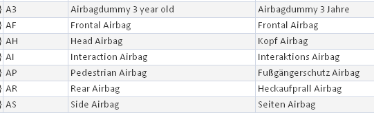

In principle that will influence if we try to find some nice/matching characters to form a "Tx" like code (like TA,….):
Or if we should change to a complete other coding like AV. But Ax is already occupied partly by:
May a complete new leading character will be the best approach to have enough "freedom" to code variants?

there comes a proposal for the:
TV – THOR-AV 50M
TW – THOR-AV 5F (Woman)
from Humanetics (Thanks Jerry!).
This could be extended in the future with TX (X => large, 95th?)
TV – THOR-AV 50M

decision on the todays ISO MME Task Force meeting:
the new codes:
TV – THOR-AV 50M
have been accepted and will be reserved in the database.
Channel list and figures from the working group will be postponed.
the new codes:
TV – THOR-AV 50M
