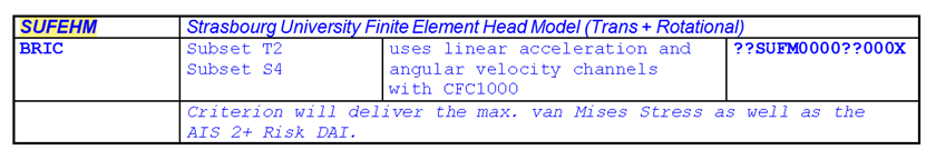

Dear Frank,
a while ago I have started to prepare a coding for RED E.
It is "work in progress" (ignore the word BRIC in the snapshot below), but may useful for the discussion:
I would like to move this discussion to the RED E board.

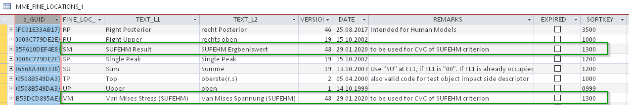

Posted: Wed Feb 05, 2020 7:19 pm
I have added to the database 1.6.2:
In Fine Location 1 table:
2020-02-05 20_03_59-Access - mme_code _ Datenbank- D__Daten_03_Projekte_10_ISO_02_DB_##Work_02_Versi.png
2020-02-05 20_03_59-Access - mme_code _ Datenbank- D__Daten_03_Projekte_10_ISO_02_DB_##Work_02_Versi.png (31.77 KiB) Viewed 52228 times

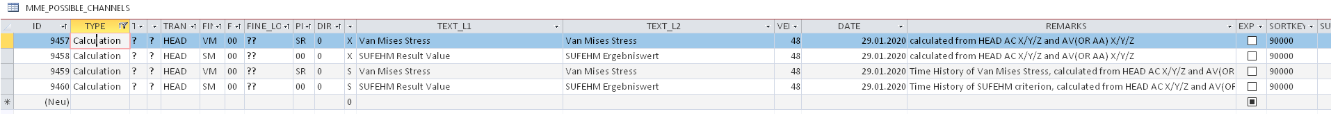

In the Possible Channels table:
2020-02-05 20_11_09-Access - mme_code _ Datenbank- D__Daten_03_Projekte_10_ISO_02_DB_##Work_02_Versi.png
2020-02-05 20_11_09-Access - mme_code _ Datenbank- D__Daten_03_Projekte_10_ISO_02_DB_##Work_02_Versi.png (30.46 KiB) Viewed 52228 times
Sorry for the small images, but they are shrinked by the system.
So please find the two images also in the attached archive.

Posted: Wed Mar 04, 2020 9:11 am
by Sebastian Rings
The "stress" (VM) is named after Richard von Mises. Therefore, could you please correct in the TEXT_L1 and TEXT_L2 "Van" to "von"?
Sebastian
Re: Channelcodes for SUFEHM channels
Posted: Wed Mar 04, 2020 3:03 pm
Dear Sebastian,
thanks for the hint.
I have changed this in the FL1 and the Possible Channels table.
