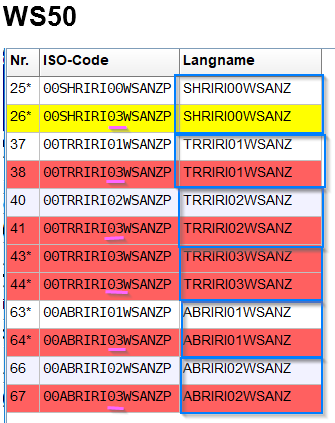

we have seen in the wild some channels for the chest/abdomen deflection that have been coded in a special way.
So there are channels for the angle measurements, that occur twice with different naming:
(the column "Langname" will show the code with the rib number associated)

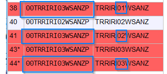

For the WorldSID thoracic ribs this will end in three channels with the same coding
for the thorax ribs:

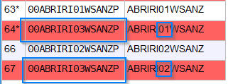

For the abdomen there will be two rib angles with the same name:

Also here you will get double named channels for the 4 thorax channels!
I guess this is not what is intended by the coding given for the THOR:
