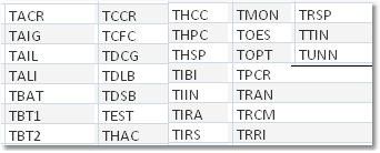

I reviewed the database:
  • no interference or similarities to existing codes
Codes with T.png (6.45 KiB) Viewed 27640 times
  • "TEYE" sounds more self descriptive (my opinion), but both sounds good in general :-)
