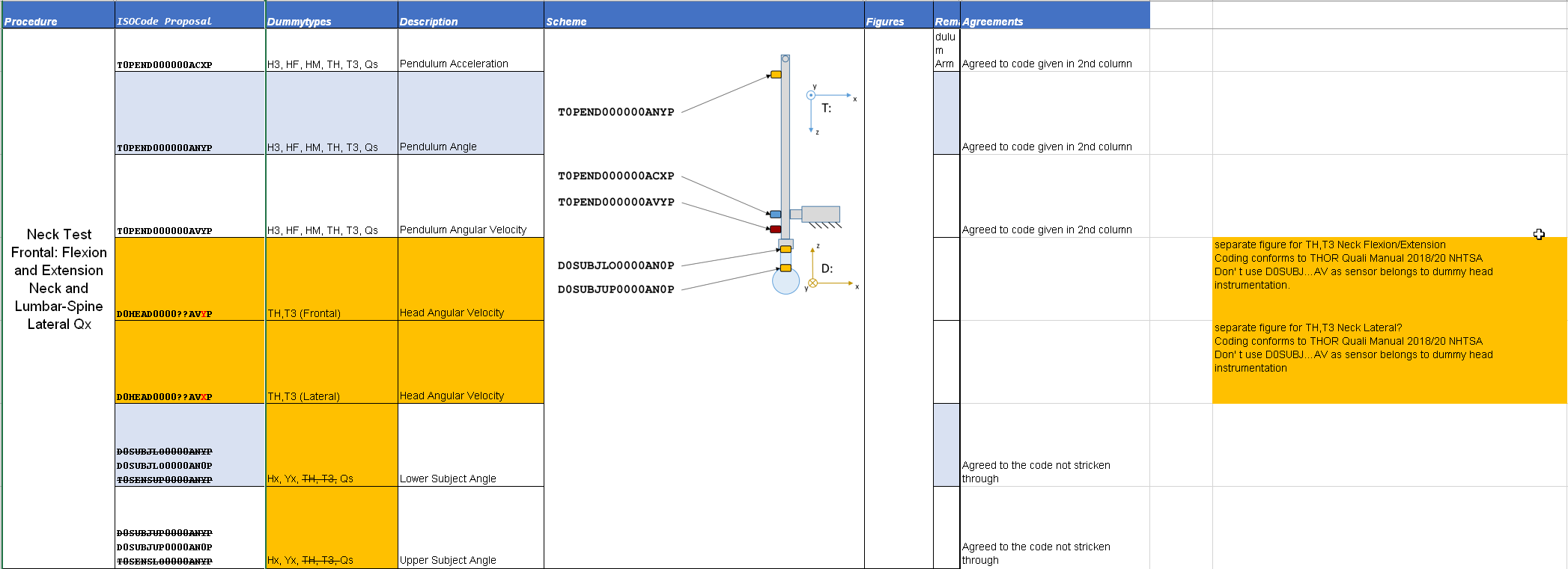

we have reviewed the current proposal and found a case that is not covered so far at the neck test for the THOR dummy:
In the specification of the NHTSA the head angle will be determined as integrated difference from an AV measurement
on the pendulum:
(in our new table T0PEND000000AVYP, without CFC applied)
and an AV measurement from the dummy head:
for flexion/extension:
for lateral flexion:
So we need to extend our table for this variant like this:
In this case, we would propose to not use a D0SUBJ... coding approad for the head sensor as this is a standard dummy sensor build in the head and already coded -> D0HEAD0000THAVX/YP
This procedure will be used for TH and T3.
