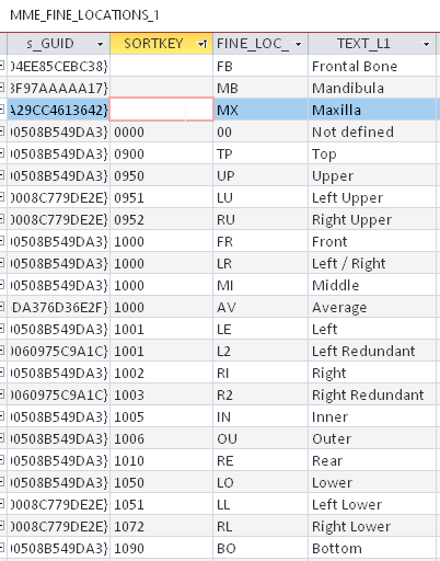

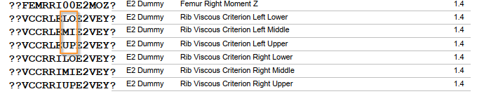

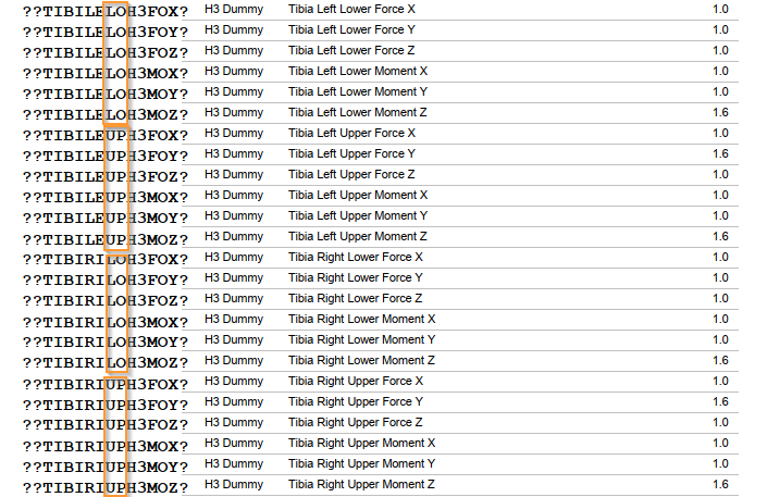

I realized that the corrent sorting based on the fine location index values leads to some unwanted orders. Like:
2021-09-20 10_39_09-2020_06_17_ISO_TS13499_RED_B_1_6_2 - PDF-XChange Editor.png
2021-09-20 10_39_09-2020_06_17_ISO_TS13499_RED_B_1_6_2 - PDF-XChange Editor.png (38.74 KiB) Viewed 24999 times
2021-09-20 10_39_34-2020_06_17_ISO_TS13499_RED_B_1_6_2 - PDF-XChange Editor.png
2021-09-20 10_39_34-2020_06_17_ISO_TS13499_RED_B_1_6_2 - PDF-XChange Editor.png (113.49 KiB) Viewed 24999 times

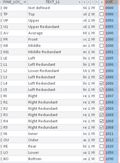

So I have changed the sorting indexes in FL1 and FL2 to allow a better sorting for the next RED B:
2021-09-20 14_23_38-Window.png (31.55 KiB) Viewed 24999 times
2021-09-20 14_24_35-Window.png (38.35 KiB) Viewed 24999 times
