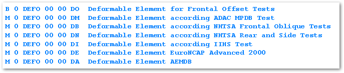

for the discussion I have listes here the current codes we have assigned for Defo Elements:
2023-03-27 10_37_49_ISO_OBJ_1_162.png (9.62 KiB) Viewed 26889 times
Beside these there are no other codes starting with a "D" character in FL3:
I guess AC stands for "Advanced China"- and "SC" for "Side China"-MDB?
If we would like to stay within this naming scheme, we have available:
DC for AC-MDB (A ist already in use for AEMDB)
DS for SC-MDB
Still my concern is that we might run out of sensible combination
for characters sometimes.
As we code in general with: M0DEFO0000...
we might use in the future the "0000" part for versioning in needed?
