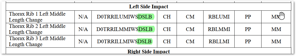

based on the NHTSA document for WorldSID Dummy Certification a new coding for the RibEye displacement has been introduced:
2024_01_Qualification Procedures_WS - DSL-Coding.png (59.14 KiB) Viewed 61664 times

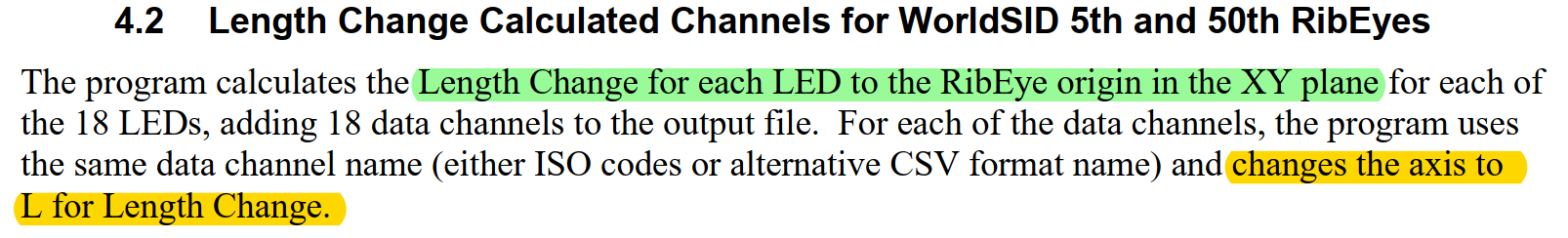

The RibEye manual gives the following details:
RibEye Software User Manual 7.0 - Length Change.png (113.73 KiB) Viewed 61664 times
Do we agree to this coding our do we propose a different coding?
The direction "L" is an expired variant that was previously used for "Steering Column".

the discussion in the task force at 2024_05_07 led to the following result:
  • The projected change in length measurement in the XY Plane is similar to the DS0 measure of the MTRAC devices
  • the coding should be changed from DSL to DS0
  • The specific coding in the fine locations 01 an 02 is a good indicator that these DS0 readings are from a RibEye system
Example:
old: D0SHRILEREWSDSLB  -> new: D0SHRILEREWSDS0B
according to the above extract from the WS RibEye Qualification Manual
old: D0TRRILUMIWSDSLB -> new: D0TRRILUMIWSDS0B
old: D0TRRILMMIWSDSLB -> new: D0TRRILMMIWSDS0B
old: D0TRRILLMIWSDSLB -> new: D0TRRILLMIWSDS0B
We will try to contact the RibEye manufacturer and finally also NHTSA to request this change in the documentation.
