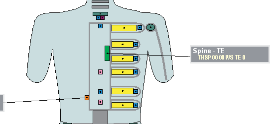

we should implement the temperature measurement location of ISO\TR 27957 in the Figures (Figure 5 for WS).
Actually we have implemented a "historic" location on the Thoracic Spine in this figure:
2024-06-25 12_55_57-.png (8.76 KiB) Viewed 27464 times
In the ISO 27957 the location is on the rear part of Rib 2:
2024-06-25 12_44_24-.png (91.26 KiB) Viewed 27464 times
In the NHTSA WorldSID qualification manual there is a requirement for a temperature measurement on the rib
for each fullbody test.
2024-06-25 15_49_49-2024_01_Qualification Procedures_WS - PDF-XChange Editor.png
2024-06-25 15_49_49-2024_01_Qualification Procedures_WS - PDF-XChange Editor.png (80.11 KiB) Viewed 27464 times
The ISO27957 is not directly referenced, but I suppose it is intended for the location.
We can code the location on the rib with side information or without:
A) ??TRRIRE02WSTE0? (just one measurement)
B) ??TRRILE02WSTE0?; ??TRRIRI02WSTE0? (two measurement or one with side position information)
How is the temperature measurement handled in the practice?
Typically only one measurement?
Measurement always on the instrumented side?
Please respect also the topic:
Position of Temperature Sensor: viewtopic.php?p=1234
Here the intention was to at least reference the ISO 27957 for all Dummy figures.
But we need to recode the location for WS and I expect also for several other dummies.

Attached is a modified version of the figure. Let me know if that is acceptable.
