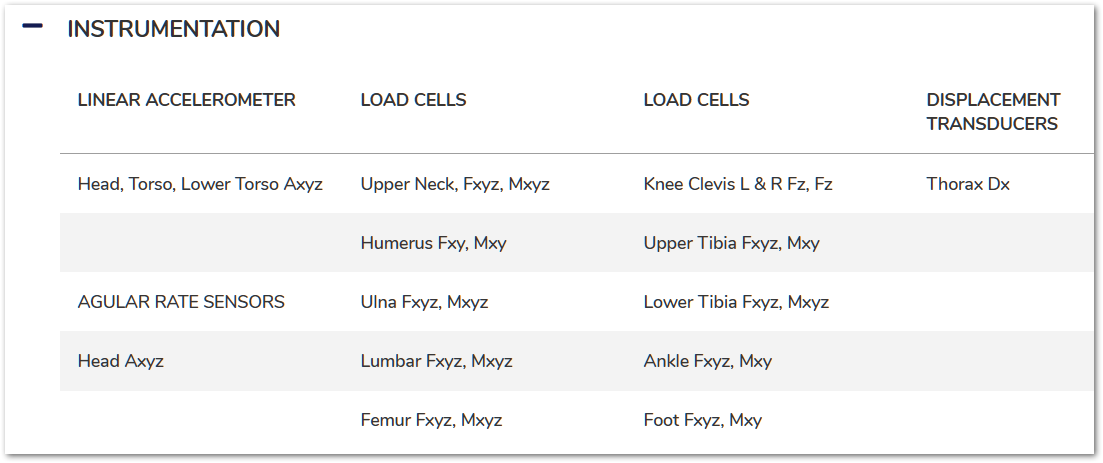

Instrumentation like this: I guess MD will do fine here. All other parts of the channel codes are quite clear from the underlying H3 base design.
