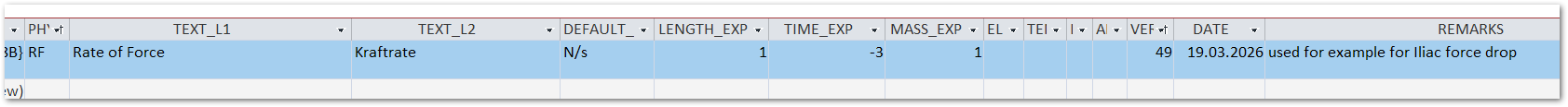

Re: ILIAC Drop Force
Agreement March 19th 2026: RF = Rate of Force will be taken.
- Posts: 471
Added to database 1.6.3p1 (2026-03-19):
