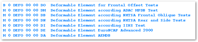

China will introduce two new kind of Moving Deformable Barrier for Side Impact:
- AC-MDB: from CEARI for C-IASI
- SC-MDB: from CATARC for C-NCAP
We need new FL3 codes for this elements.
Proposal:
AC-MDB: DC Remark: DA is used by AE-MDB
SC-MDB: DS
Björn
Other Objects - Deformable Elements - SC-MDB & AC-MDB
bjoern.hohage
- Posts: 22
- Joined: Wed Jan 11, 2017 12:44 pm
- Company: AUDI AG
- Posts: 470
Re: Other Objects - Deformable Elements - SC-MDB & AC-MDB
Dear Björn,
for the discussion I have listes here the current codes we have assigned for Defo Elements: Beside these there are no other codes starting with a "D" character in FL3:
I guess AC stands for "Advanced China"- and "SC" for "Side China"-MDB?
If we would like to stay within this naming scheme, we have available:
DC for AC-MDB (A ist already in use for AEMDB)
DS for SC-MDB
Still my concern is that we might run out of sensible combination
for characters sometimes.
As we code in general with: M0DEFO0000...
we might use in the future the "0000" part for versioning in needed?
DS for SC-MDB
