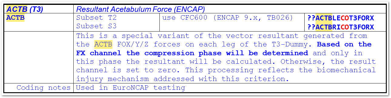

Resultant Acetabulum Force ENCAP (revised):
2022-12-13 14_45_08-ISO_TS13499_RED_E_163.docx  -  Compatibility Mode - Word.png
2022-12-13 14_45_08-ISO_TS13499_RED_E_163.docx - Compatibility Mode - Word.png (31.28 KiB) Viewed 44487 times

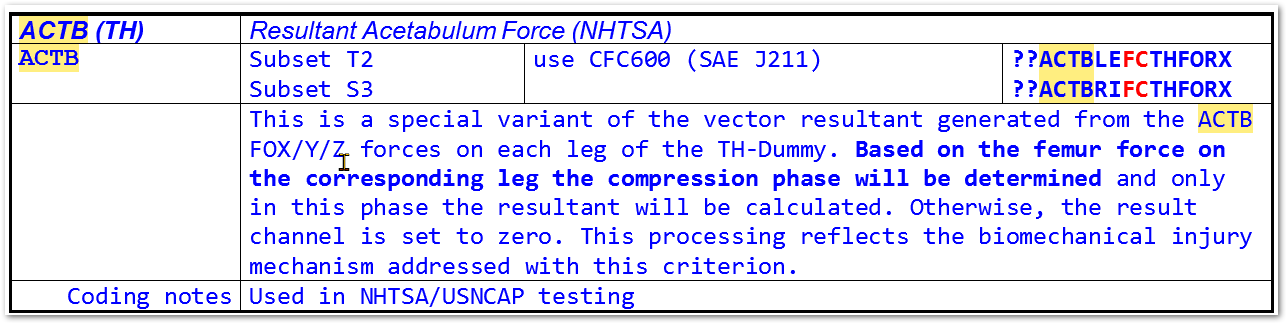

Resultant Acetabulum Force NHTSA (updated):
2022-12-13 14_45_43-ISO_TS13499_RED_E_163.docx  -  Compatibility Mode - Word.png
2022-12-13 14_45_43-ISO_TS13499_RED_E_163.docx - Compatibility Mode - Word.png (39.47 KiB) Viewed 44487 times
Also an proposal to change from "Courier New"to "Consolas" font for the tables?
