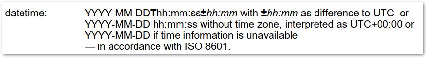

ISO 2.x:
The "Date of the test" descriptor can also hold time and time zone information:

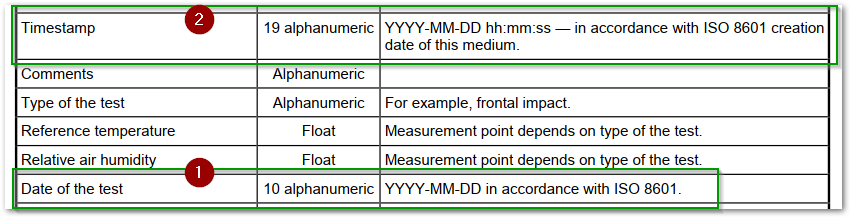

ISO 1.x: Standard and REDs
In the official document the "Date of the test" descriptor has no time information included (see 1):

ISO 1.x: in practical use
Some datasets do already include the time of the test noted in the same way as in the "Timestamp" descriptor.
(see above 2)
I would like to collect feedback of the users and software providers on the handling of this information.
my intention is to document the handling of the time of the test information in the new RED A for V1.x.
