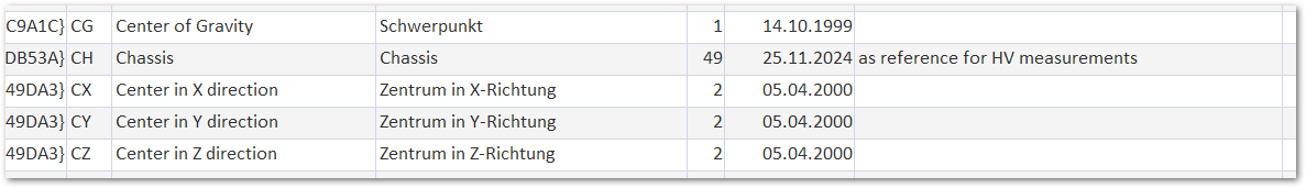

It is a good idea to harmonize. In the current database there is nothing
implemented from the 2012 proposal and the coding would be available:
2025-09-29 13_46_58-Access - mme_code _ Database- D__Daten_03_Projekte_10_ISO_02_DB_##Work_01_Versio.png
2025-09-29 13_46_58-Access - mme_code _ Database- D__Daten_03_Projekte_10_ISO_02_DB_##Work_01_Versio.png (15.43 KiB) Viewed 4770 times

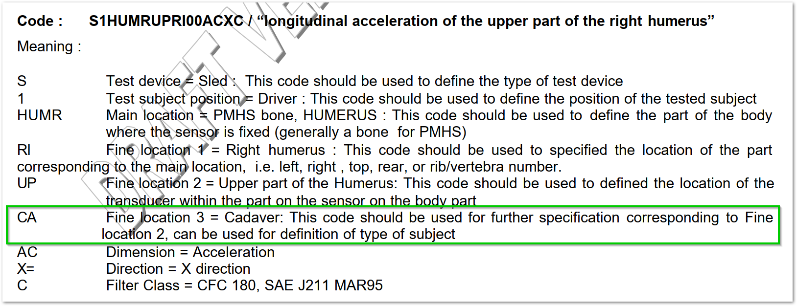

For the other forum member I have here a snapshot from the draft version provided in the Humos2 Project in 2012:
2025-09-29 13_59_41-Humos2_draft_report_ISOMME - PDF-XChange Editor.png (266.05 KiB) Viewed 4770 times
