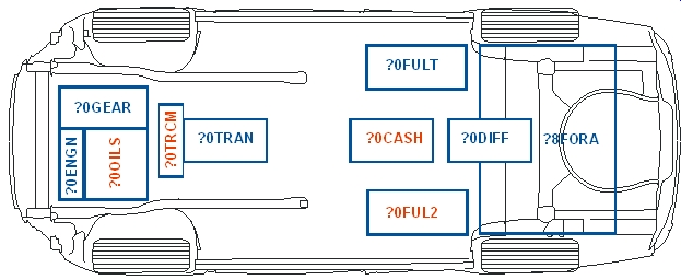

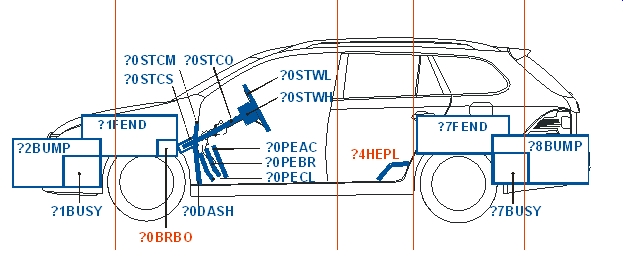

we need 3 new MainLocations for the vehicle surface and structure:
  • OILS Oil Sump (Ölwanne)
  • BRBO Brake Booster (Bremskraftverstärker)
  • HEPL Heel Plate (Fersenblech)
The MainLocations are also shown in Figure ISO_VEH_B2 and ISO_VEH_S3 for MME 1.6:
Vehicle Side 3
Vehicle Side 3
Vehicle_Bottom_2
Vehicle_Bottom_2
Re: New MainLocations for vehicle surface and structure
integrated into database and figure for v1.6
