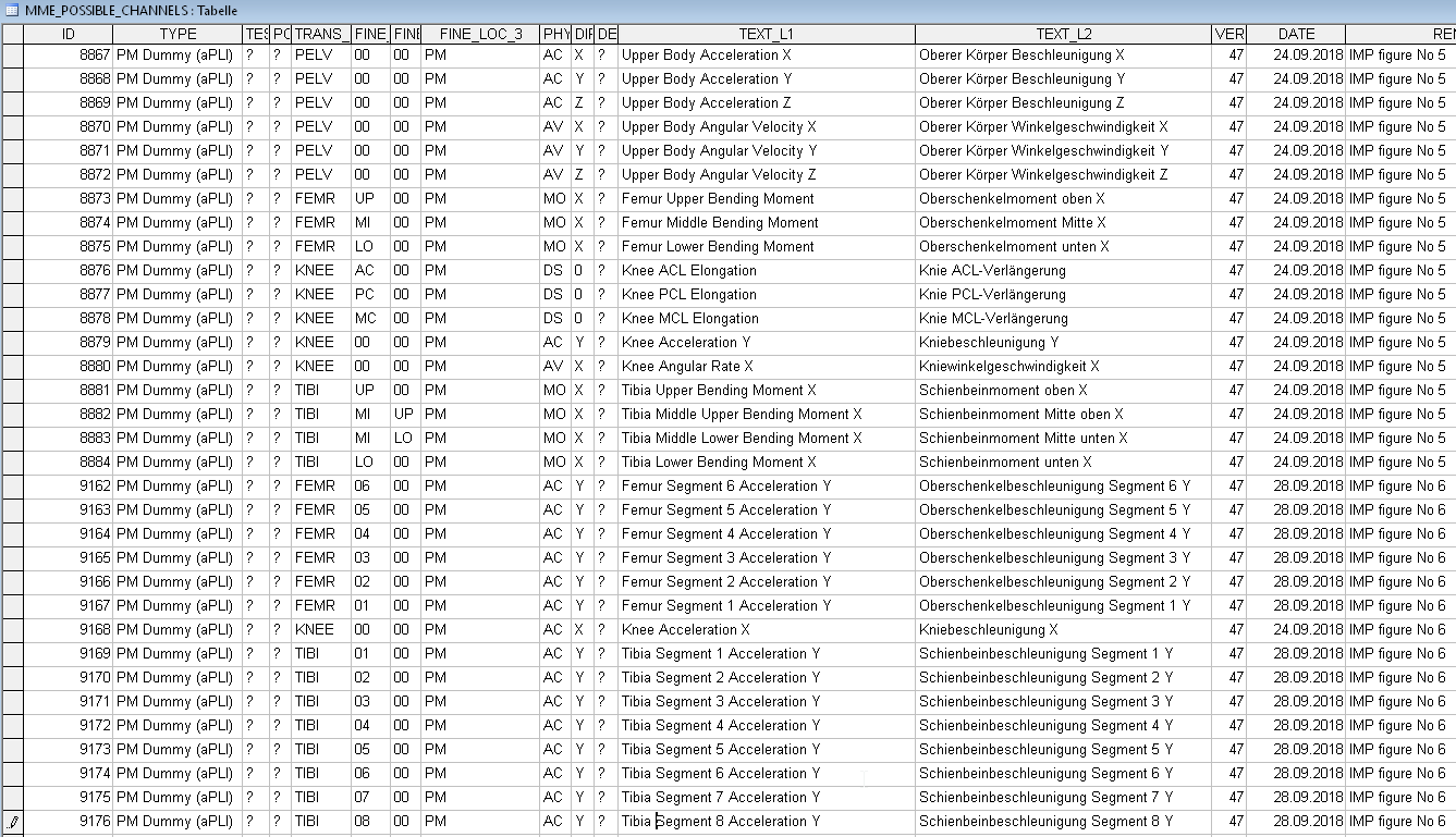

all codes have now been introduced in the database (1.6.2 Proposal 3) and are referenced
in the IMP(actor) figures No 5 and 6.
Please find the two figures and a snapshot of the Possible Channel table here:
ISO_IMP_5+6_162p3_20180928_aPLI_PM.pdf
(31.7 KiB) Downloaded 1206 times

Re: New codes for ISO TC22 SC36 WG5 aPLI Pedestrian Legform
so the naming for the PELV-channels has also been changed in the database accordingly:
