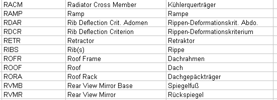

Please find attached an updated version of the SEAT figure page 1 with the new code.

So the new ML-Code entry will be:
ML     English                       German
ROPS   Rollover Protection System    Rollover-Schutzsystem
But I am not sure if we should provide the hint in the figure to use the
coding only for the "rear" seats for ROPS.

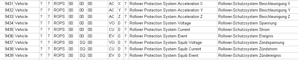

the following codes have been added to the Possible Channels table in the database:
