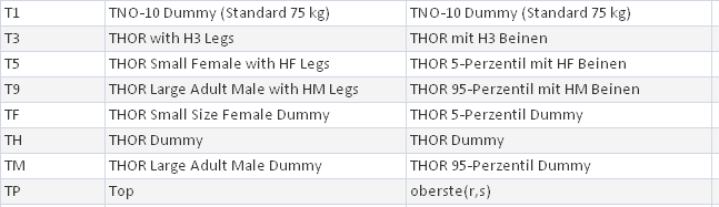

In principle that will influence if we try to find some nice/matching characters to form a "Tx" like code (like TA,….):
2020-03-10 14_13_25-Access - mme_code _ Datenbank- D__Daten_03_Projekte_10_ISO_02_DB_##Work_02_Versi.png
2020-03-10 14_13_25-Access - mme_code _ Datenbank- D__Daten_03_Projekte_10_ISO_02_DB_##Work_02_Versi.png (11.56 KiB) Viewed 33550 times

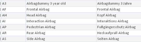

Or if we should change to a complete other coding like AV. But Ax is already occupied partly by:
2020-03-10 14_13_04-Access - mme_code _ Datenbank- D__Daten_03_Projekte_10_ISO_02_DB_##Work_02_Versi.png
2020-03-10 14_13_04-Access - mme_code _ Datenbank- D__Daten_03_Projekte_10_ISO_02_DB_##Work_02_Versi.png (8.41 KiB) Viewed 33550 times
May a complete new leading character will be the best approach to have enough "freedom" to code variants?
Any input of experts/engineers that are working in that area is welcome, to be able to realize a
future-prove naming concept.

there comes a proposal for the:
TV – THOR-AV 50M
TW – THOR-AV 5F (Woman)
from Humanetics (Thanks Jerry!).
This could be extended in the future with TX (X => large, 95th?)

decision on the todays ISO MME Task Force meeting:
the new codes:
TV – THOR-AV 50M
have been accepted and will be reserved in the database.
Channel list and figures from the working group will be postponed.
