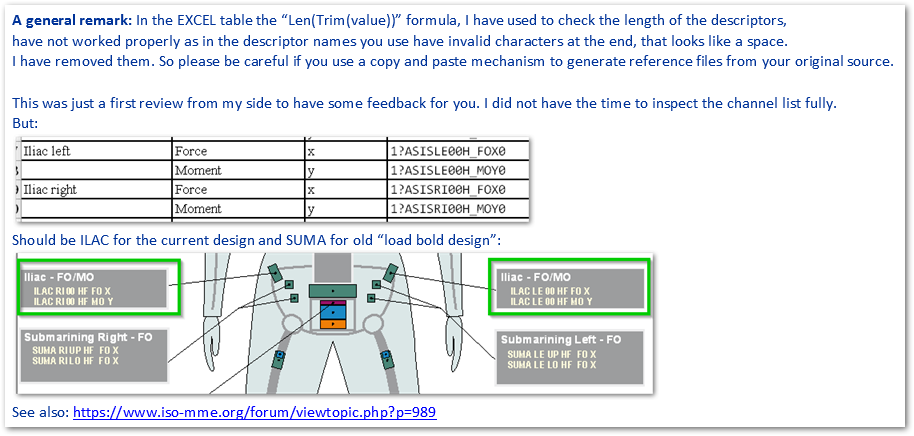

Re: EuroNCAP VTC reference data
Based on the first document I checked the descriptor length in the proposal and send some comments:
2024_07_15_MME-Files-VTC_DiVe.xlsx
(16.22 KiB) Downloaded 1255 times
And the comments from the E-Mail:
