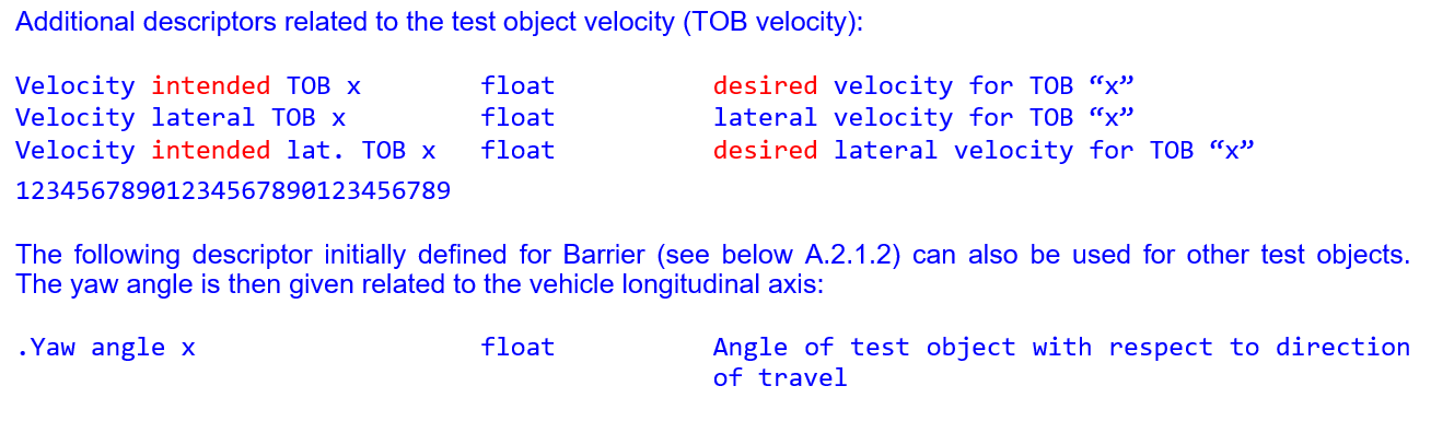

Re: RED A (1.6.3) Proposal 1
Posted: Tue Feb 24, 2026 3:36 pm
minor changes in the velocity descriptions has been applied:
RED_A_V16Rev3_20260223 - Velocity Descriptors.png (114.66 KiB) Viewed 68277 times
Final document is now:
ISO_TS13499_RED_A_V16Rev3_20260223.pdf
