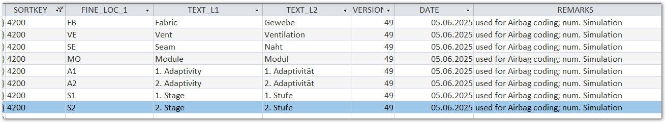

in the database I have now prepared the following extensions for the ew Airbag coding:
Extensions for FL1:
2025-06-06 13_26_14-Access - mme_code _ Database- D__Daten_03_Projekte_10_ISO_02_DB_##Work_01_Versio.png
2025-06-06 13_26_14-Access - mme_code _ Database- D__Daten_03_Projekte_10_ISO_02_DB_##Work_01_Versio.png (28.89 KiB) Viewed 15794 times

Please report back to me if the translations are not matching the intended code part.
