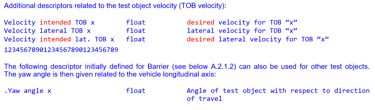

Re: RED A (1.6.3) Proposal 1
Dear All,
after the meeting with the Active Safety WG today the new velocity descriptors have been
revised:
Please find the complete RED A document proposal with the latest state here:
ISO_TS13499_RED_A_V16Rev3_20260218.pdf
(173.35 KiB) Downloaded 764 times

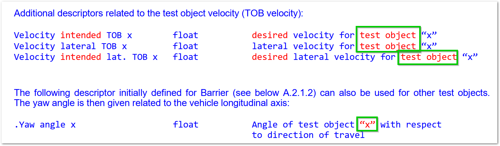

minor changes in the velocity descriptions has been applied:
RED_A_V16Rev3_20260223 - Velocity Descriptors.png (114.66 KiB) Viewed 67644 times
Final document is now:
ISO_TS13499_RED_A_V16Rev3_20260223.pdf
(67.95 KiB) Downloaded 824 times
