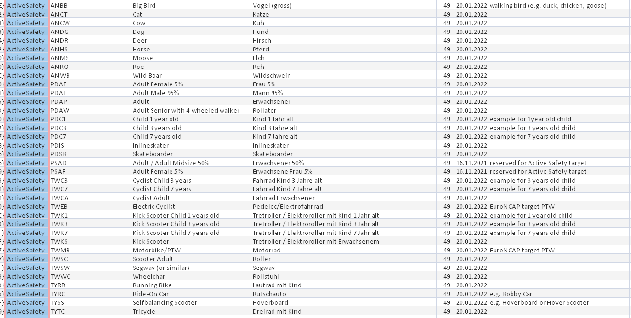

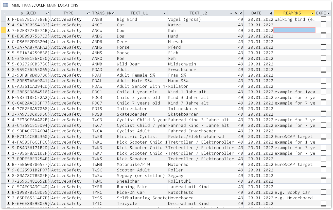

Re: Proposal for main locations of different targets
I have added the proposed mainlocation to the database:
2022-01-20 18_20_27-Window.png (104.28 KiB) Viewed 47813 times
Find also attached a current snapshot of the backend database.
based on the feedback of Mr Washausen I have corrected the table.
Please find here the latest status:
2022-09-13 14_53_08-MME_Database-Active_Safety_ML_codes.png (165.02 KiB) Viewed 47212 times
An open point for the future discussion might be the age groups to be used with the proposed:
TWCx, TWKx and PDCx
codes.
Currently they have been implemented for 1,3,7 years.
Dirk Vetter
