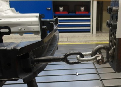

we need a new main location for the towing lug.
It is used in Towing/Pressure Tests at the front and rear end of the vehicle -> Positions 1,2,3,7,8,9
Measured physical units are DS and FO.
Proposals for the naming:
TOLU - towing lug - Abschleppoese
TEYE - towing eye - Abschleppoese
Best Regards
Example for position 3
